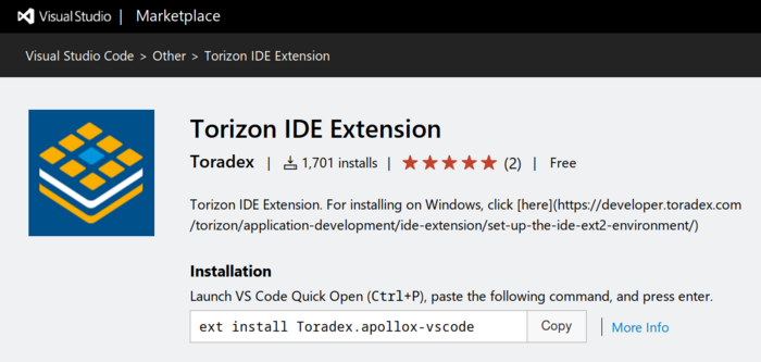

The latest versions of the Toradex Torizon Support extension can be found on the Visual Studio marketplace, in two versions:
Close all running instances of Visual Studio. Choose one of Torizon extensions from the above, download and install it.

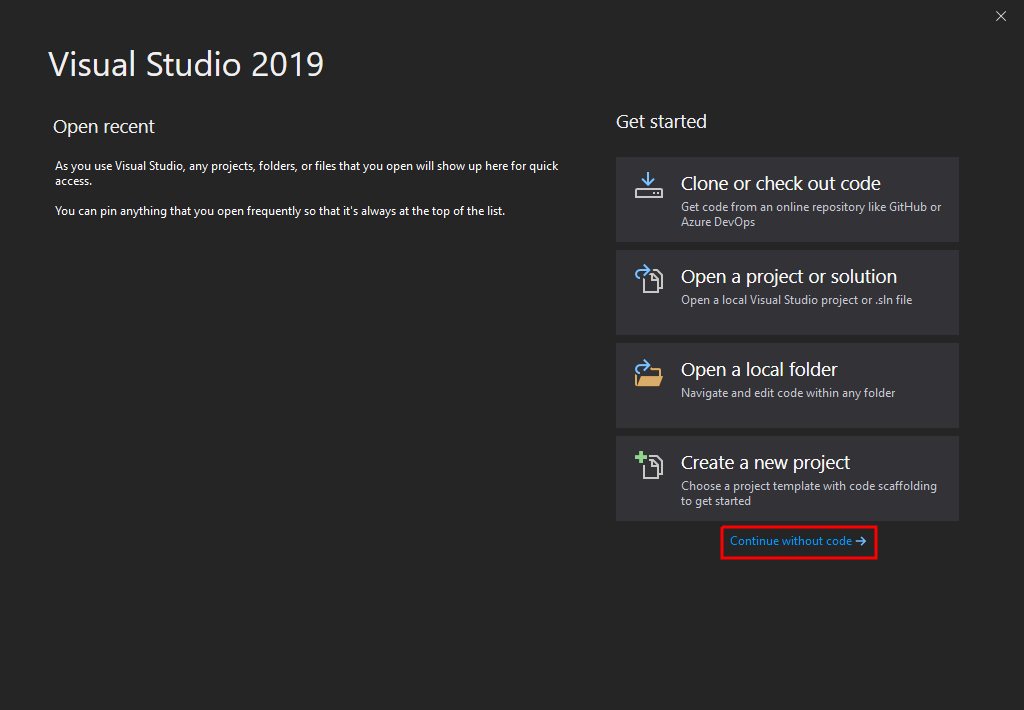

After installation, open Visual Studio for a first configuration of the work environment for Torizon. After opening Visual Studio click on Continue without code:

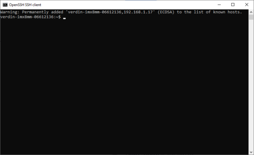

It's also possible to open an SSH Terminal directly from the Torizon Devices Explorer, just right click on the device and choose SSH Terminal option:
You will end up with an OpenSSH Client with access to the board:

Access the Visual Studio Market Place and click on the Get Started button:
This will download the Visual Studio extension TorizonVSExtension.vsix file.
Warning: Before installing, make sure there are no instances of Visual Studio open.
Double click on TorizonVSExtension.vsix to start the installation. The following window below will be shown:
Select your Visual Studio version and click the Install button. Wait until the installation process is complete.
