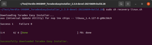

The USB OTG approach establishes a connection between your development PC (Host) and the module (Client): A recovery script will be launched from your PC, which will automatically load and execute Toradex Easy Installer in the module.
Over this process, Toradex Easy Installer is first saved in the PC, loaded from there, and executed on the module's RAM.

$ cd <unzipped directory>
$ recovery-linux.sh
Note: During the recovery process, the module connected via USB may re-enumerate several times.
If downloading gets stuck or fails with an error, try starting over from the recovery mode article.
  • Example of output after successful execution of the recovery script
